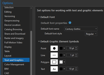

Is there a way to set the default font for ArcGIS Pro? I have changed the default font under options, but when I make a text box or a legend in my project it still defaults to Tahoma.

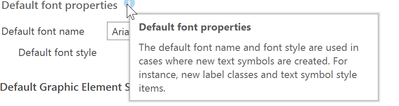

Here is what the default font covers
Text on a map—ArcGIS Pro | Documentation

Yes I am using the maplex labeling engine. And that is where I changed my default font but it is still Tahoma when I add in a new text box or anything with text.
BenPearse
Oh I see what is happening. If I create new labels for a layer they use my default font settings. Which is great, but is there no way to apply this to the default font for the legend or other text boxes?

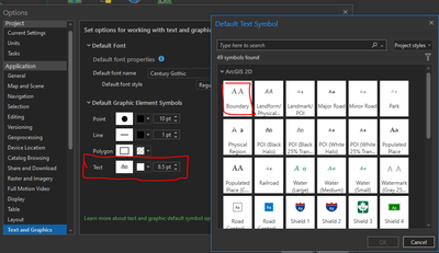

I followed that link but still couldn't get it to work. I changed the Default Text Symbol to "Boundary", then when I added a text box that became my default font, but I can't figure out how to add a new project style with the font I would like.
