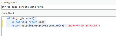

I didn't have any field types that matched those in that help doc, but there are a bunch of date fields in my feature class. I deleted all the date fields and it published to Portal just fine. That's not an acceptable solution, but at least I've narrowed it down a bit. For a temporary work-around, I created a text field to hold the date, calculated it like this, and then deleted the date field:
I was then able to add a date field on the hosted feature layer, add it as a layer in Pro, and calculate the field based on the text value:
This is a lot of shenanigans, so not a good workflow, but I guess it technically works. I'll post an update if I figure anything out, but I need to switch gears at this point.
