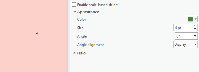

KoryKramer
Esri Community Moderator
Michael, there isn't a setting that I'm aware of to control the "pop-up tolerance."  Note that the Explore tool acts on a feature's symbol rather than the xy location.  So the ability to "hit" a 20 pt point symbol is easier than a 4 pt points symbol.
