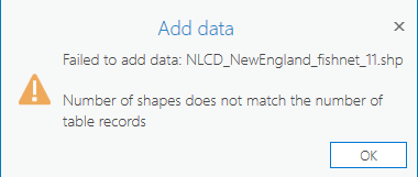

Update: I change the code to adopt two more functions: make feature layer and save layer to file. The code runs but it does not produce shapefile that is openable. The error message says below. I am going to stop updating, and maybe someone someday will find a solution to this problem...
