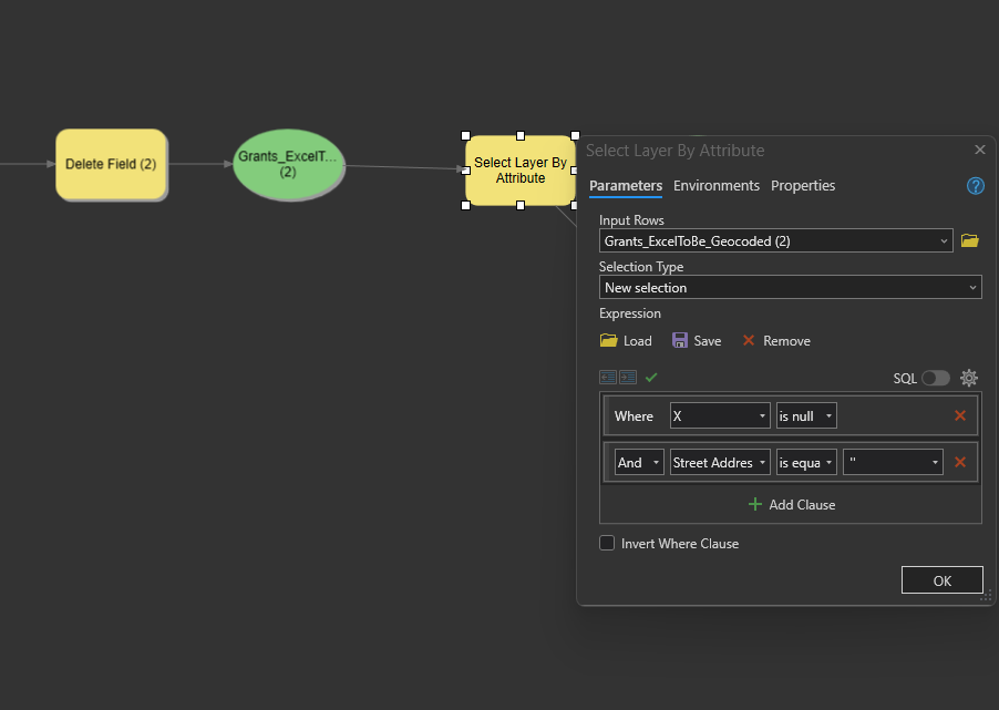

So I have this Excel XLSX file that I am bringing in as a GDB table into a model builder. I added a `Delete Field` tool to delete two columns (which works fine) and then I connect the output of that to the `Select Layer by Attribute` tool.  But, the `Select Layer by Attribute` tool query doesn't work, like it does not return any selection, even thought the query works fine outside the model.
X IS NOT NULL And Street_Address = ''

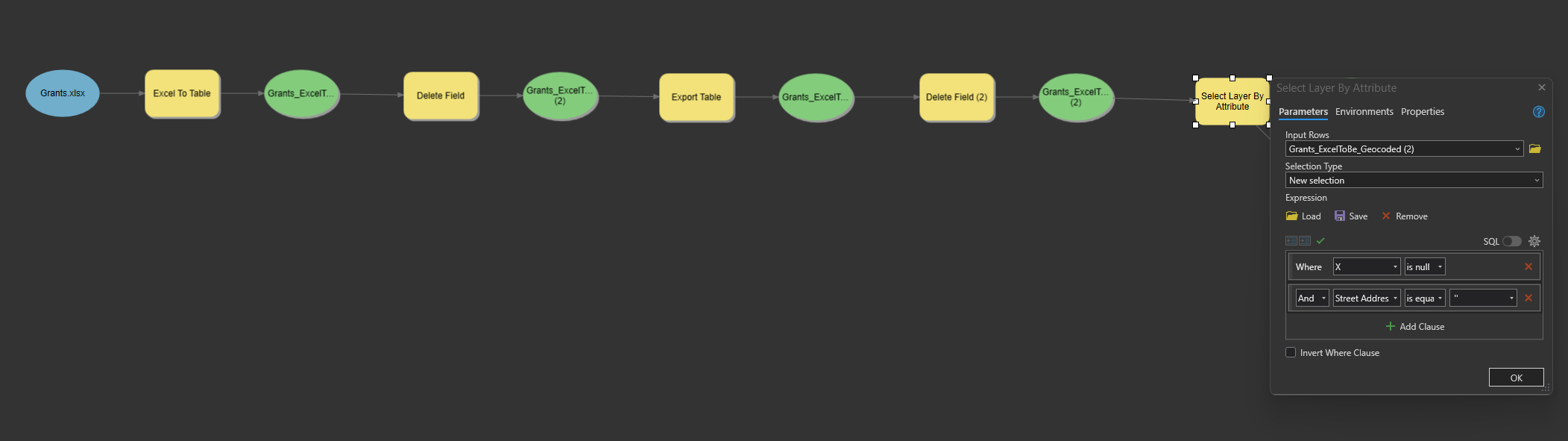

Whole model:

The same  query works fine outside the model builder on the same dataset.

I ended up using the `Export Table` tool to run the query (which now works) as well as delete the columns I don't need in one go.
