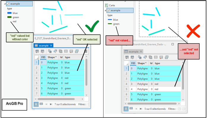

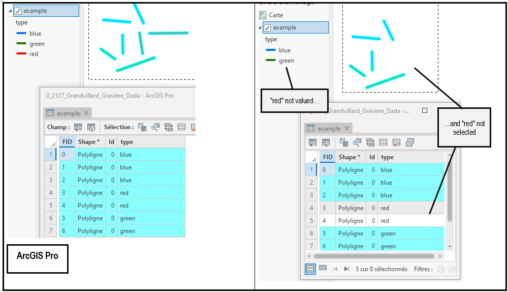

When i use unique value symbology, i can choose to not symbolize all values.
But then i can not graphically select the features that aren't valued/symbolized/visible on the map.

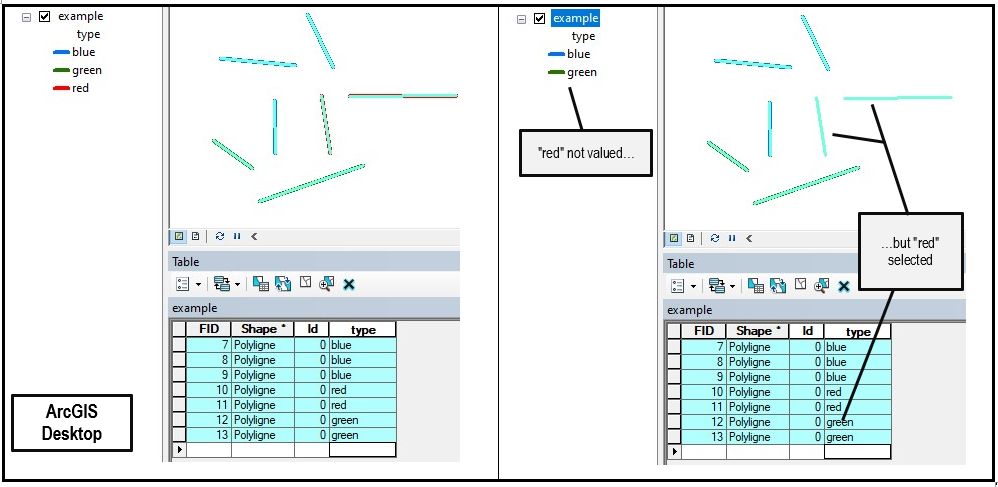

On ArcGIS Desktop it would select all the features, regardless of the symbology.
GregoireS_2-1647449458164.pngGregoireS_2-1647449458164.pngGregoireS_3-1647450184685.pngGregoireS_3-1647450184685.png

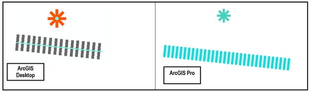

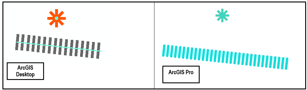

I can see the purpose of Pro's version, and sometimes it's useful, but sometimes not. Can we choose and use the old way ?
Is it also possible to choose the old way which the selection appears, as a simple point/line regardless of the symbology ?
If it's not possible, then please move the topic to ArgcGIS ideas, thanks 🙂

GregoireS
Thanks for the answer.
@RhettZufelt wrote:
Even if you keep the item in symbology, but give it a color of Null, it will not select it.
Seems like a bug to me since what color (or not) you choose to symbolize by, shouldn't definition query it from the display.
> That's wrong, in this case it does. Maby i have to correct/precise : it depends not on the presence of a color but on if it's valued or not. See image below.

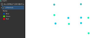

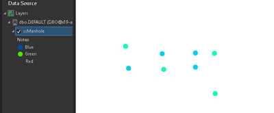

Upon further testing, you are correct.  I tested with points, and figured it would work the same as lines:
RhettZufelt_0-1647528895599.pngRhettZufelt_0-1647528895599.pngRhettZufelt_1-1647528906571.pngRhettZufelt_1-1647528906571.png
My previous post refers to the behavior with points.
Using Pro 2.9.1

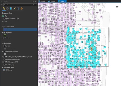

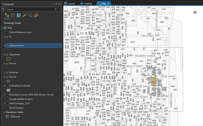

Hm, that doesn't seem to work for me. I have a point layer that I'm just using for labels, so I have it set to transparent, but when they are transparent, I cannot select them. I have to toggle them to a color each and every time. It would be great to have the option, whether per feature, per map, or app-level, to include invisible features in selection. There is a 'keep invisible features selected with new selection' option, which I thought would work, but it does not.
