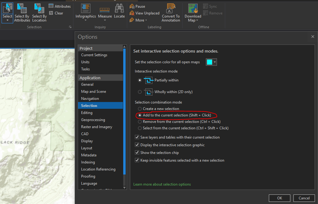

As a workaround, aren't you able to finish a polygon selection, then pan, then hold Shift and draw another polygon, etc.?
Or set your interactive selection to Add to the current selection:
by Anonymous User
Not applicable
Yes, that's the only workaround that works for now.
