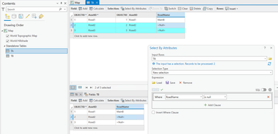

I've joined TABLE_A to TABLE_B via common ASSET_ID text fields using Add Join. The join is one-to-many: 1 row in TABLE_A to 4 rows in TABLE_B.
I want to select from TABLE_B.ROAD_NAME (text) where ROAD_NAME is null. However, Select By Attributes doesn't seem to work correctly. It selects all four rows, regardless if ROAD_NAME is null or not.

  1. I have the same issue in ArcGIS Pro 2.6.8 in a file geodatabase and in an Oracle 18c 10.7.1 enterprise geodatabase.
  2. I don't have this problem with definition queries in ArcGIS Pro 3.2.2, only with Select By Attributes. There is a separate issue in 2.6.8 with definition queries: Esri Case #03387420 - Definition query on join returns incorrect rows.
I don't understand how that issue has been around since ArcGIS Pro 2.6.8 (or earlier) and is also in 3.2.2. How could such a serious issue not have been fixed as of 3.2.2?

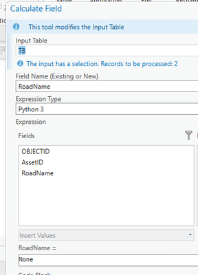

What if before join you run 'Calculate Field' tool on <Null> fields and run the query:
Then, perform a join and run 'Select By Attribute' tool?

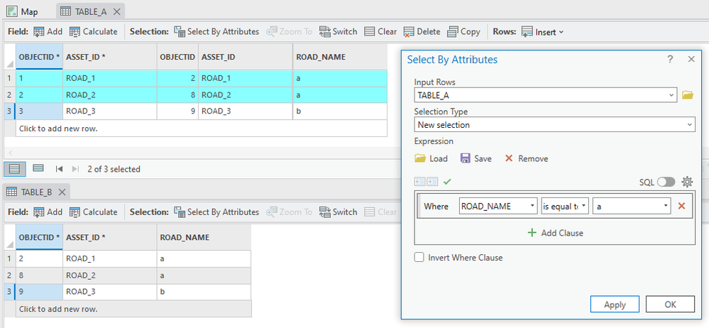

@GeeteshSingh07 As the bug suggests, the issue isn't specific to nulls. It applies to any value. The bug title described it fairly well.
The bug title states the problem is with the duplicate ObjectIDs, which seems accurate. ArcGIS Pro is very dependent on ObjectIDs, so best guess is: it's making the selection using a given ObjectID. Since there are duplicate ObjectIDs, it's selecting all rows that have that ObjectID, which is incorrect.

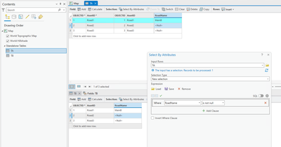

Here's an example of Select By Attributes working correctly on joined data, since for all rows, the join is 1:1:

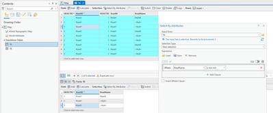

It turns out the issue doesn't only apply to Select By Attributes. It also applies to manual selections.
With a 1:m join, if I manually select one of the rows that is 1:M, then all rows in the 1:M group will get selected, which is incorrect.
