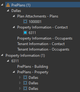

RPGIS
by MVP Regular Contributor
Actually if you pull up the attributes rather than the tables themselves then you will see the related records, both forward and backward.
