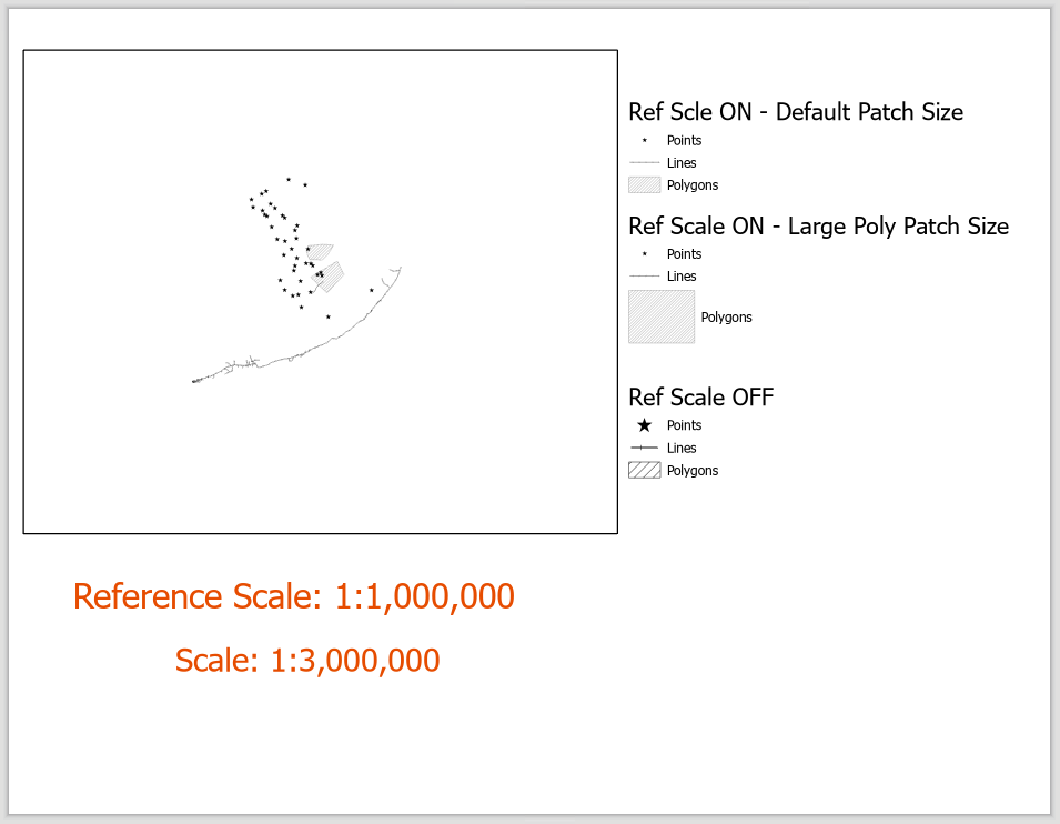

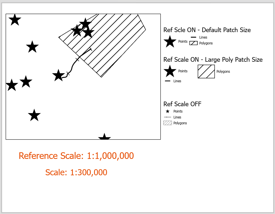

Here is what I'm seeing with the fix that is available in ArcGIS Pro 2.7.  Here is my test layout example:
The map scale is the same as the reference scale set for the map.
Here is a zoom in. Notice that the legend symbols adjust as expected for the top 2 legends where the Legend is toggled to respect the map's reference scale. The bottom legend has this property toggled off.
Next, is a screenshot of the map frame zoomed out. Though it may be hard to see in this screenshot, but the symbols in the top 2 legends match what is displayed in the map at this scale.

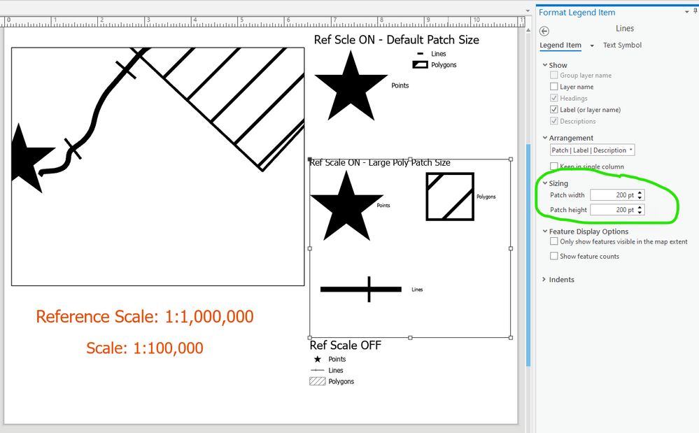

Finally, we have an extreme zoom where I needed to increase the overall available space available to the legend (as indicated by the element selection box/handles). I also increased the size of the patch (height and width) for both the line and polygon items to accommodate the symbol's size in the middle legend while not adjusting the sizes in the top legend.
As you can see the top legend does not have enough space in the legend patch to accommodate the size of the symbol. Line and Polygon patch sizes DO NOT automatically change size. To do so would be an enhancement to Pro and would be a good thing to add to Ideas if you are so inclined.
Perhaps this is what you are seeing?

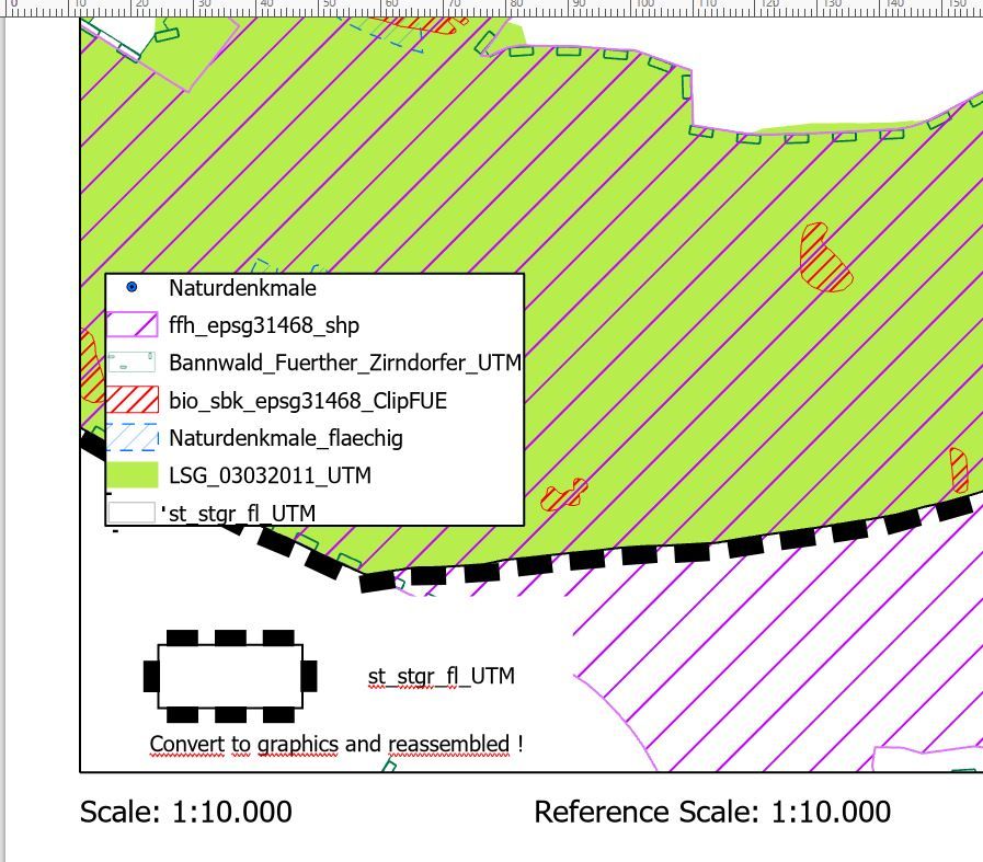

I was able to understand what you said by using an example. However, that doesn't work with my symbology. What I need for my work is a representation of a marker symbol placed along the outline of a polygon, see the thick black bar line:

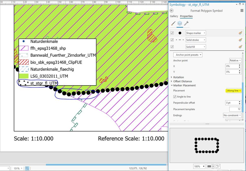

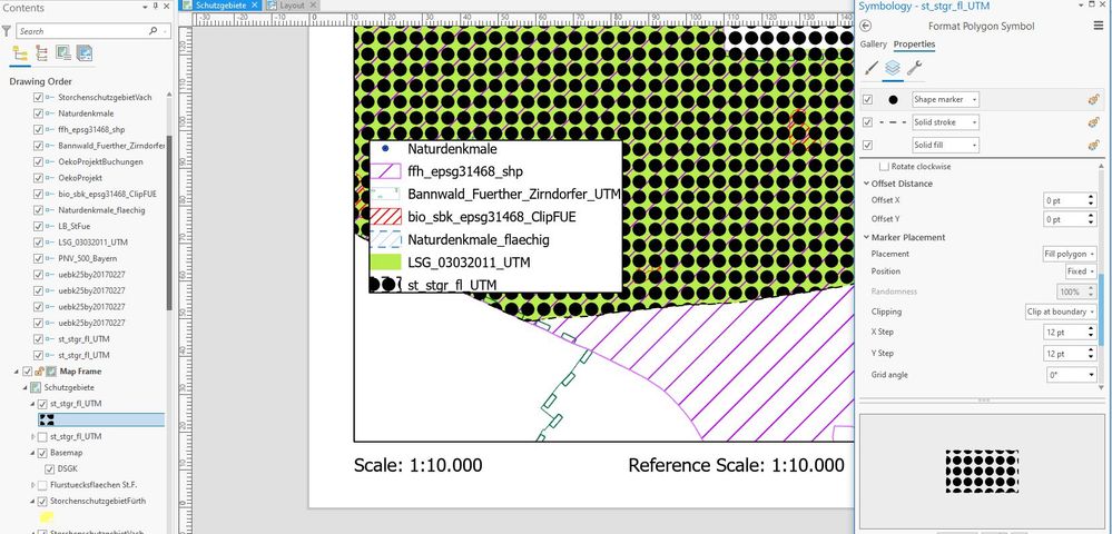

So I tried to get closer to the problem and was able to find out the following: if you fill a polygon with marker (Fill Polygon), the referencing scaling works well, but not if you use "Along line" als marker placement.
So my alternative workaround at this point is to convert the legend to graphics and reassemble the legend item, as seen below:

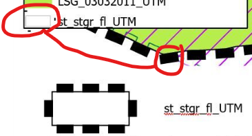

Christian,
I think you missed an important point in my explanation above.  The legend patch size does not change automatically. You can set it to be larger if you need to accommodate larger symbols. However, if the symbols in the map are larger than the size allotted to it in the legend (via patch size for lines and polygon features) you will get the results you are seeing.
The size of just 1 dashed in the polygon outline is just about the same size as the legend patch.
The patch size in your legend is not large enough to accommodate the size of the symbols at the smaller scale. Here is an example of a polygon with a dashed outline.  The default patch size for the legend item (24 pt X 12 pt) is not large enough to show the outline around the patch. If you increase the size of the patch you can see the outline.

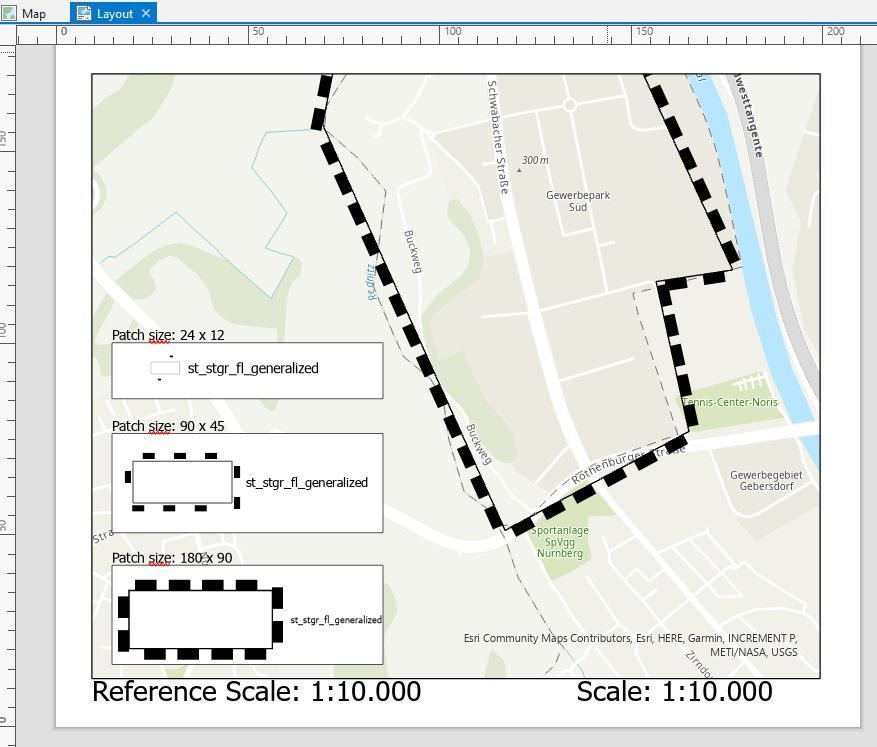

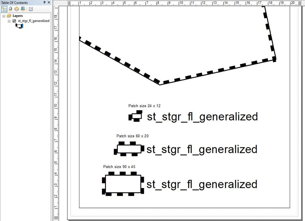

Sorry, but I disagree with your explanation. Of course, it can be advisable to adapt the patch size to the symbols for reasons of better representation. But the size of the symbols must remain the same and only depend on the reference scale. By the way, it works well in ArcMap, as you can see: the size of the (marker) symbols used is retained, even if the patch size is changed:
AGP is acting strange here. In the following example I have successively changed the patch size in AGP in order to approximate the representation in the map:
Already at the chosen patch size of 90x45 the marker symbols could be displayed correctly, but I think that may not be the way to go! Think about of more elaborate legends and you would go insane if AGP's behavior wasn't predictable. Please try it out for yourself using the symbol configuration of the attached Lyrx file. Thank you!
