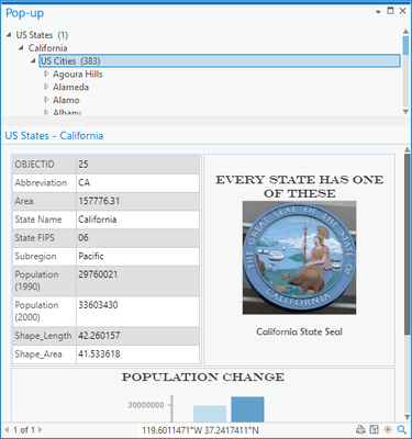

With a Relate, you use the tree-nodes at the top of the popup to navigate to the related content - for example, all the cities in a state (screenshot below). This works well for 1-to-many relationships (eg: from a building to all the rooms inside it), but it sounds like your relationships are more the 1-to-1 type.
