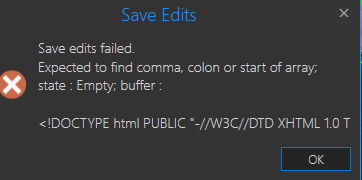

I have been working on a project in ArcGIS Pro 2.1.2 and as of this morning have been unable to save my edits that I have made to data in a map (in map mode, not layout mode). I am able to make the edits, but when I go to save them I get the following error window:
Save edits failed screen

I have tried to edit several different layers (ensuring that I am only editing one layer at a time), and each time I have received this error. I have also shut down and restarted the program several times and this problem is still occurring. I have even removed the map and added it back in to the project, and the error still occurs each time I try to make edits. This leads me to believe that it is an issue with the project itself, but I am not sure what kind of issue that would be. I have looked around to see if anyone else has had the problem, but have been unable to find any such forum post/Stack Exchange/etc.

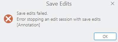

FerdieRatum
I encountered this in an Annotation feature class. After some tinkering, I found that recalculating the Spatial Index (Feature Class Properties: Annotation > Indexes > Spatial Index > Recalculate) solved the problem.
Hope this helps in similar cases.
