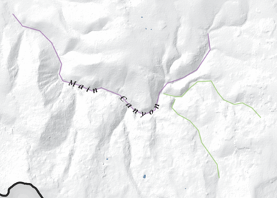

Label with "street" placementLabel with "street" placement
I'm currently using Street placement, because I want the ability to control the spread of both words and letters. If I use the default settings of any other placement style, "Canyon" in the example above is spelled out fully.

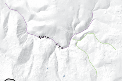

Label without "street" placementLabel without "street" placement
My desired spreading is 500% for words and 200% for letters, but even with 0% "end of street clearance" and no potential conflicts with other labels or features, the labels like to abbreviate when they don't need to. Is this a bug or is there some functionality I'm not understanding?
To troubleshoot, I used the Main Canyon feature above at a single scale and tried every potential combination of word and letter spreading to look for a pattern. If there was an option to spread by a percentage, I tested 1%, 500%, and 1000%. In the end I didn't see anything obvious. Here's what my results were, if it means anything more to you:

Result: "Cyn".

My guess as to why Cyn shows up is because at that scale, the labelling engine is picking out a line segment from your canyon lines, so that it sees it as a smaller feature. Maybe try merging the line segments for each canyon into one. Just a guess!

This was it! If I use Smooth Line to make the line a nicer curve (which was the eventual plan anyway), the label generates like you'd expect it to. Weird but ok! Thanks for the help.
