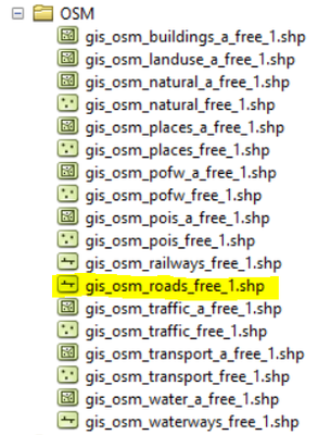

One way is to download the OSM Shapefiles (.shp.zip) from http://download.geofabrik.de/ (Click on the Continent Name to see the list of countries).
e.g. For Asia, http://download.geofabrik.de/asia.html
Note: The zip file will consist of many other layers as well, but you can choose to use the desired layer(s) in ArcGIS Pro.
