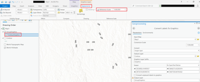

Change the appearance of a graphics layer
"Define the Reference Scale value to determine at which scale the graphics layer appears at the intended size. When this property is set, changes in scale result in graphic elements changing size relative to surrounding features. You can also set a custom scale, or choose <None> to stop applying a reference scale."
