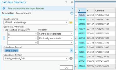

If you want to use BNG it's under Projected Coordinate System > National Grids > Europe > British National Grid, though you can just say same as the layer or map if they are already in BNG
