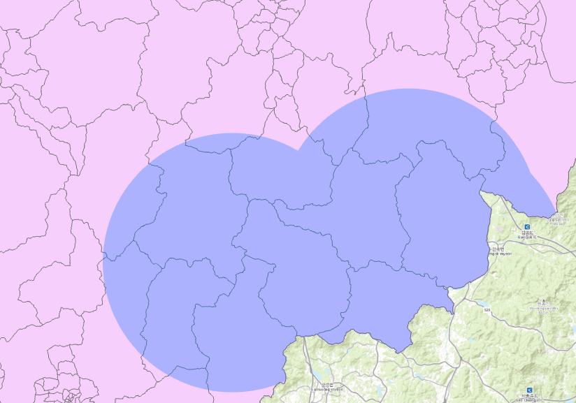

Hello, I have two layers. One is the layer of administrative districts, and the other one is some buffer layer. So when I overlapp two, the picture looks like below :
Each features of administrative district layer(pink) are district, of course. I want to screen the districts that 'contain' the buffer poligon(blue). In other words, I want to make a layer of districts which contains a part of buffer poligon, regardless how much area the contained buffer is.
And I want to extract the whole feature of district, not the only part which is overlapped by buffers. So 'clip' cannot be a solution for me at this case.
As I know, there is a tool that can do this kind of thing...but I don't remember😭
Please help me!

Select Layer By Location (Data Management)—ArcGIS Pro | Documentation
with the intersect option I would assume.  Once selected, export/save the selection to a new featureclass
