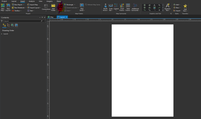

this is so simple but I've been unable to figure it out.
what is the simplest way to resize a map frame in an existing layout?
instructions I've found online haven't been correct.
Thanks to all.

Right click the map frame in TOC and click properties or just use the resizing handles in the map.
temprobertcottreau131313
how do you activate the resizing handles?  I'm not getting them
I want to make the map frame bigger on the page/take up more of the page
right click on Map Frame and select Edit Vertices
SLouq
by MVP Alum
MVP Alum
you have to be in Layout view.
Once you have added a layer in Map View, Click Insert -> Layout View. Then click Map Frame and add the map view to the layout.
From there you should see the map handles
