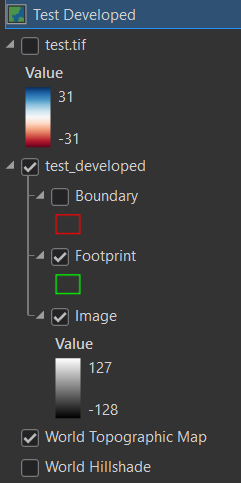

I am having a problem with the mosaic dataset showing an incorrect data range (max:127, min: -128) for a signed 8-bit Tiff file (maxi: 31, min: -31, see the image below). There was no problem when I added the original Tiff file which was a signed 16-bit. However, it didn't work well when I publish it online to visualize time series. I have 50 Tiff files in a mosaic dataset so no wonder.
