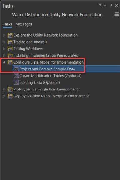

Hi @DeepikaJain01 !
If working with the solution, there should be a Task in the UN Solution that walks you through re-projecting the data! This should be the Change Asset Package Spatial Reference Tool. I opened the Water Distribution solution and this was the task I was referring to if it's helpful!
https://doc.arcgis.com/en/arcgis-solutions/latest/tool-reference/utility-network-package/change-asse...
