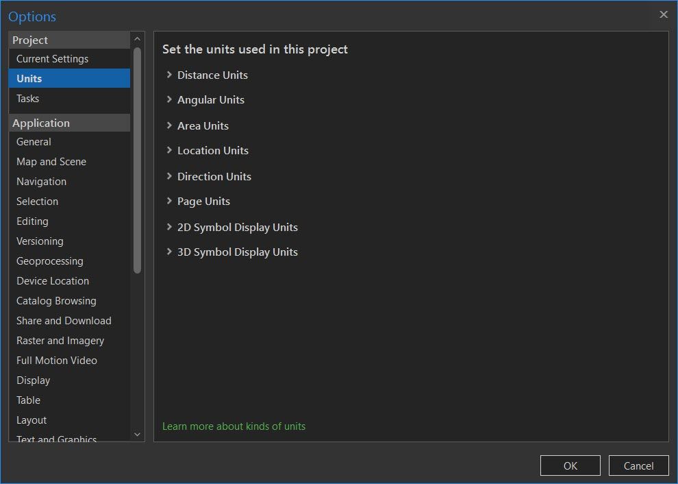

Are you working with a Prosettings.config file to configure the settings? I didn't see a way to change the units that way:
https://pro.arcgis.com/en/pro-app/latest/get-started/administrator-settings-list.htm
but there is a Units section in the ArcGIS Pro options where you can change the Location Units, among others:2023-08-10_8-28-36.jpg

I do have the values (decimal degrees) set in the Units section under Options but this doesn't change the Display Units at the bottom of the map. At the moment, I'm looking for anyway to set these as a default when the software is installed via SCCM. If it's an entry in user.config, creating a prosettings.config or a new/change to the registry i'm happy to do that.

Hey @AnthonyRyanEQL ,
I unfortunately couldn't find a way to apply this setting to all projects, so I don't believe it is possible unless someone has found something different.
There was an enhancement request logged for this: ENH-000107562: There are currently no options to establish default settings for the whole ArcGIS Pro Application for Units. but the recommendation that came from this enhancement was to create a Project Template.
I ran a quick test where I changed the Unit to DDM, created a Project Template and the default setting carried over with the template, if that is helpful.
