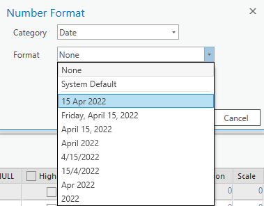

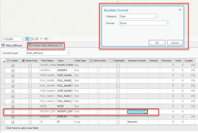

The first thing I would try is to go into the Fields view of the Attribute Table.  Check your number format for your Date fields.
Set each date field to how you want it to display.
