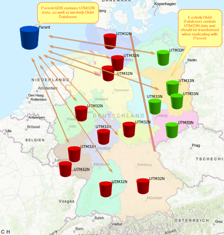

I am looking into setting up a replication process where datasets in different coordinate systems  (UTM32N - EPSG 25832; and UTM33N - EPSG 25833) are automatically transformed during replication between Parent (UTM32N) and some of the Children (UTM33N) in germany.
Is there a recommended approach or best practice in ArcGIS Pro / Enterprise to configure replication so that parent and child feature datasets may differ in their spatial references?
In particular, I would be interested in:
  • whether this is supported directly in geodatabase replication,
  • how different coordinate systems are defined in some of the children (green databases in the picture),
  • and if there are any limitations or recommended architectures for this setup.

Yes, there is a way to do this as referenced in this Esri Community post - Create Replica with Different Output Coordinate Sy... - Esri Community - but the technical article referenced in the post no longer exists for some reason.  I'll continue to look for it though.
