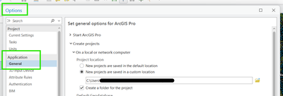

Hi @DaveMartin1
I never use my default gdb. You can set your projects to save in any location you choose in Project/Options.
