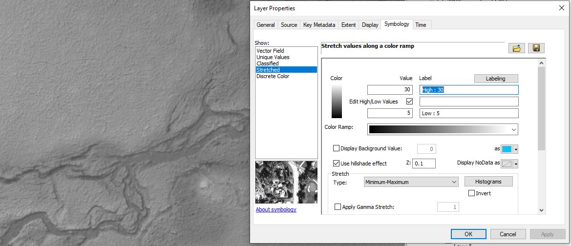

In ArcMap 10.3, under the raster symbology window, there is a quick & easy hillshade option under the checkbox 'Use Hillshade effect', as below:
This checkbox appears to be combining several raster functions in order to produce a non-faded hillshade effect, but I've no good idea which ones.  This quick combination checkbox doesn't seem to have any analog in Pro, so what I wan to know is how I can replicate this functionality in Pro?  Is there a quick way I'm missing?  If not, which functions is ArcMap's 'use hill shade effect' box combining?  I can make a hillshade underlay layer using Pro's Raster Functions->Surface->Hillshade tool, but I can't get it to look the same (I'm running Map & Pro side by side for comparison) so I know Map is doing more than just cranking out a hillshade underlay like Pro does.  Also of note I don't have 3d or Spatial Analyst for either products.
