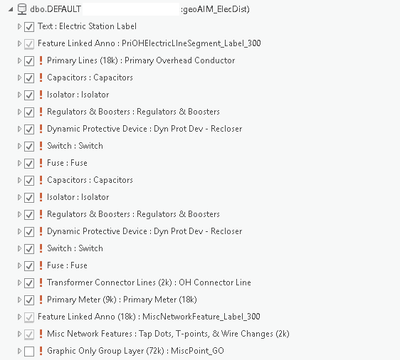

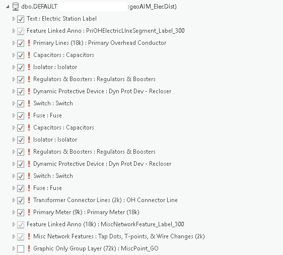

I was given a map and half of the layers have broken links. I have tried to reset the data source which worked for some of the layers. However other layers are refusing to repair.
I have tried resetting the data source in the Properties - Not working - I get an error here that says layer data source could not be changed
I have tried to repair the data source using the red ! - Not Working
I have tried to reset the data source using find and replace - Not working
I have to be doing something wrong. I dont understand why I was able to change the source on some layers BUT not others.
All of the layers reside in the same FDS in the same Enterprise GDB which is reflected in the map.
None of the names have changed and I can manually locate the FC without issue.

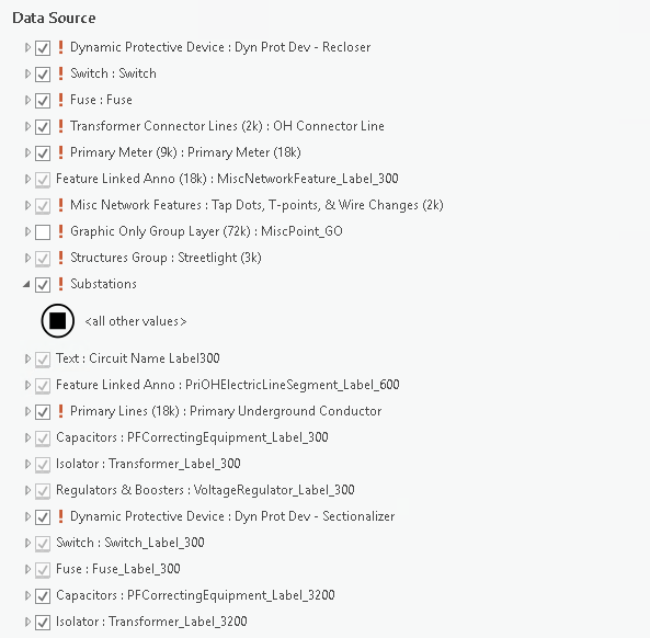

JacquelineAlessi
I have found that it is actually stemming from an issue in the ArcFM Object Converter, although all of the FC have been converted to ESRI objects some of them are still holding the CLSID that was associated to ArcFM. My issue is much more complex 😞 Truly appreciate all of the input.
I converted the objects back to ArcFM and then over to ERI Objects again, and was able to resolve SOME of the layers, and all of the tables.
