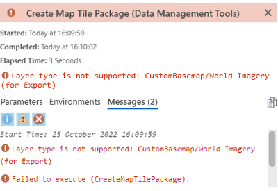

When I try to create a map tile package in ArcGIS pro, I get the error "Layer type is not supported: Map/World Imagery (for Export)".

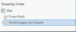

This is my Drawing order:

I've been doing that but I can't seem to be able to export the vector tile layer combined with the world imagery as a tpk or tpkx. I then get the following error:
My intention is to combine the world imagery with a vector tile layer that hides the ocean and later export it as a tpk or tpkx file so that I then can load it in Unity.

Sorry, I didn't read closely enough.
So, I've attempted it several times myself, and it looks like Tile Packages don't like Imagery Layers.
