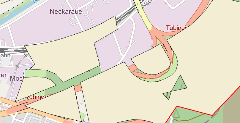

Hey all,
I'm trying to remove not suitable areas from my polygon. To be more specific, I'm trying to identify (and erase) areas ("islands") <23ha, because they are not suitable (too small) for wind energy systems. The goal is to have an overall area on which wind energy systems can be employed.
Bildschirmfoto 2022-05-06 um 13.20.15.pngBildschirmfoto 2022-05-06 um 13.20.15.png
The image illustrates my problem; e.g., the small 'islands' are not suitable and should therefore be removed. However, it would not make sense to clip them manually, as there are just too many. Therefore: How can I identify these areas and have them removed from my polygon?
Thanks so much for your answers!
3 Solutions
TomGeo
I take it your polygon is a multipart geometry... In the geoprocessing tools you find 'Multipart To Singlepart', did you try that to separate the multipart input features into singlepart features?
You can then filter the singlepart features by their area and delete those you find not to fit your demands.
If your question is only about on how to filter and delete features based on their attributes... The 'Select By Attributes' tool is your friend to specify your terms, then you simply delete the selection.

TomGeo

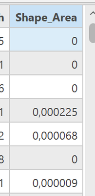

Thanks for your help! Just one more question: What would 23ha (230000 square meters) be in the Attribute Table? I don't really get the comma value.

RhettZufelt
MVP Notable Contributor
The Shape_Area field is reporting square map units.
You should be able to use the Calculate Geometry Attributes GP tool to add a new field and calculate area as Hectares.  Then you just select where Hectares < 23 and delete. Or, do the math on how many square map units are in 23 ha, then select, etc.
R_
TomGeo
The geometry attributes calculation tool can be started by right-click on the attribute tables column header…
