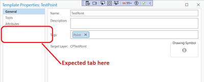

I'm probably missing something basic, but I'm trying to create a template favorite with a feature and a related record.   There is a relationship present associating these things.  The feature is the origin of the relationship.  The relationship is present in the catalog pane.  And the relationship rules allow creation of a relationship between the origin and destination subtypes.
However, the "Relationships" tab does not show up on the Template Properties dialog for the favorite.

Realized a screen shot might be helpful here...

So.. a little more info here.   I was able to get this to work on a file geodatabase (a gas UPDM asset package).  But not in the case where UN features are published through a feature service.  The related table is present in the published service, but its not clear if the relationships are...  I suspect this might be the root of the problem.

I see further what I am missing.   The associated records would be be part of a containment association -- for which there should be a side tab present on the Template Properties dialog, but there is not.
