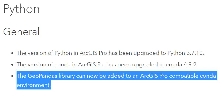

I have Arcpro 2.8 patch2 - which mentions that installation of geopandas has been fixed.

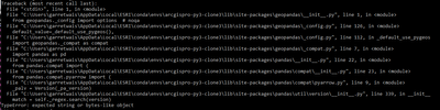

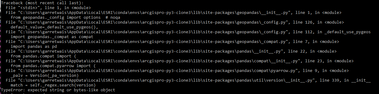

My experience is that after creating the python env clone, using the arcpro gui to install geopandas, fails without error message. Using the Python Command Prompt using "conda install geopandas" succeeds in the installation of geopandas but importing within python fails.
geopandas error:
fiona error:

And this is what happens when I import fiona or run geopandas.read_file()

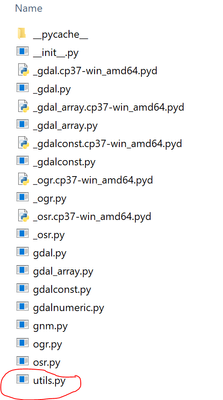

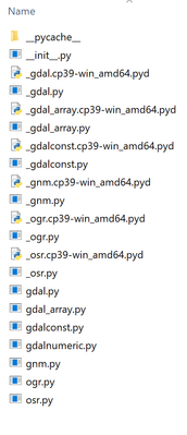

I compared the osgeo folders for the two environments:
For the arcgis-pro based environment (clone of arcgispro-py3; fiona doesn't load on it):
Then for the non-arcgis environment (in which fiona correctly loads):
The most notable difference is that the arcgis env contains a script utils.py,while the non-arcgis version does not contain it.
