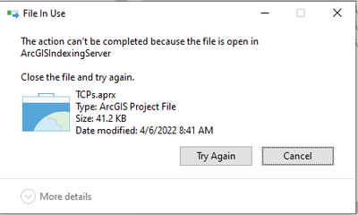

The new version I can open and edit. the old version is still locked. Here's the message I get when I try to delete it:
DanPatterson
MVP Esteemed Contributor
don't know what ArcGISIndexingServer is, but by chance is there non-local data in the aprx?  If so, try remove any layers that aren't locally stored incrementally with a save after each removal to see if you can narrow down the offending data

Simon_Kedward
I'd be interested to know if deleting the index and cache works.

Robert_LeClair
Esri Esteemed Contributor
Matt - let's try to disable the ArcGISIndexingServer process and see if that resolves the locked/read-only *.aprx.  To do this:
1). Close ArcGIS Pro.
2). Go to Start Menu> Search for "Task scheduler" > Open Task scheduler.
3). On the left hand pane in Task scheduler, Click on Task scheduler(Local) > Task scheduler library.
4). In the list scheduled tasks, locate the task with name like "ArcGIS Pro Indexing (Your_Username)" >Right click on the task> Disable the task.> Close Task Scheduler.
5). Reboot the machine
Once you reboot the machine, attempt to load the *.aprx in question.  What is the result?

Robert_LeClair
Okay - next thing.  In ArcGIS Pro, go to Project-Options-Application-Indexing.  Click "Don't create index" and uncheck "Update the index periodically"  Then close ArcGIS Pro, redo the steps for Task Scheduler.  What is the result?
