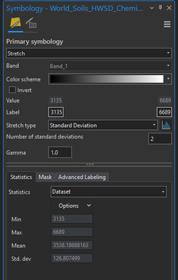

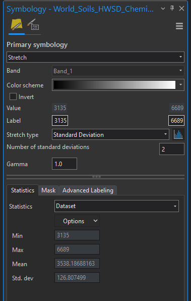

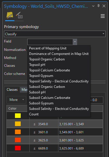

The raster has a single band, and the default values shown are the unique ID assigned to the soil group. The raster contains a variety of attributes, such as "Topsoil pH" and "Topsoil Organic Carbon". When I try to symbolize the raster by stretch, there is no option to symbolize by these fields; I can only symbolize based on the unique ID. However, if I use the "classify" symbology option, the "Field" dropdown allows me to choose these fields.
I would like to be able to symbolize "Topsoil pH" with a stretch symbology, and not be limited to binning.

Fields can be selected above.
Fields cannot be selected using the stretch option
