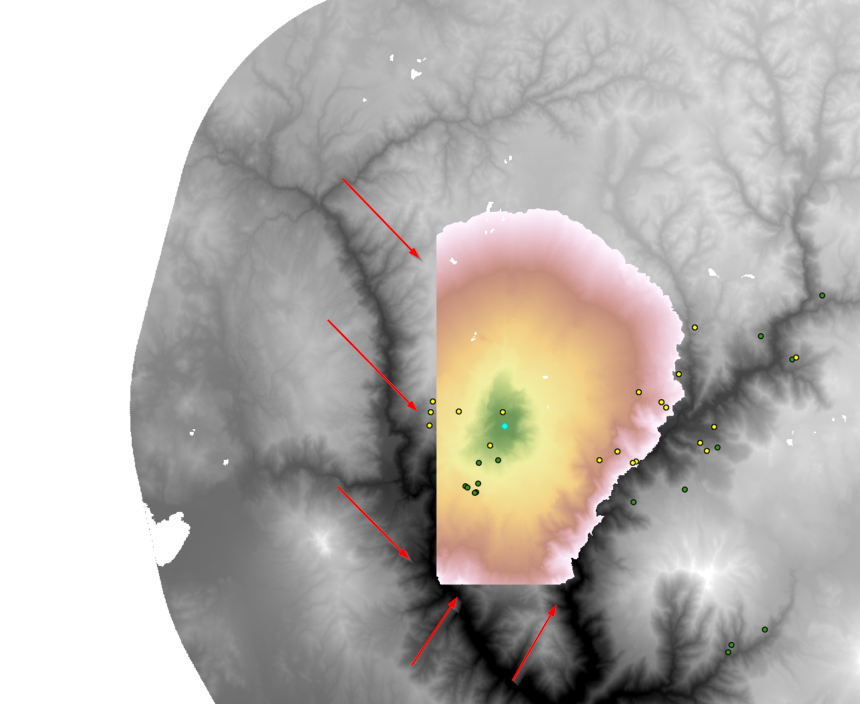

I am running into an issue where the distance accumulation tool does not provide a complete output raster. Instead, some edges of the raster are cut off, as though they were not included as part of the analysis (red arrows below).
I am using ArcGIS Pro 3.1.1 (I just updated it and got the same issue before and after I updated the software). I am running the analysis in model builder, though I have gotten the same issue when running the distance accumulation tool from the geoprocessing window. All of the data is stored on a SSD local drive. I ran this analysis iteratively across a large dataset (~1500 source points), and this issue only impacted the results of some of the points.

The resulting raster is not always cut off in the same way. I've had instances where the northern edge is cut off, but not the southern edge. My only inkling is that there is something having to do with the memory or temporary storage, but it's mostly a guess. The tool (and model) run without issue in my original project--there are no reported errors.

My hunch at this point is that the points that failed were in areas with very high cost and irregular topography and the issue was caused by a lack of computing resources. But please, let me know if I'm off base!
