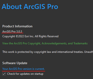

Hey all,
Just wondering if anyone has come across this issue before. When looking at the "About" page in Pro, it states that my "ArcGIS Pro version is current" despite being at Version 3.0.3.
Though I imagine the easiest fix to update to the most current version would be a simple uninstall/re-install, just wanted to reach out to see if anyone has come across this before.
Thanks

No problem on my installation (3.2.1), but I have a standalone installation so I control everything.  If you are part of an organization, perhaps it restricts updates at their leisure.

Though I am part of an organization, I do have admin control for software installs and updates. I wonder if the update check is being restricted by our overarching IT department's firewall though.

@Vinzafy We had two computers displayed this message. I am currently investigating the cause of the issue. CIS updated these computers to version 3.4 in November while I was away, but encountered difficulties. Today, we uninstalled and reinstalled version 3.5.2, as the updates would not proceed automatically. At this time, I have not been able to determine the reason why these two computers prevented the update process. I am glad to see I am not the only one to experience this.

Interesting.  I have not seen this before.  You could do a soft factory reset of ArcGIS Pro without uninstalling/reinstalling the software.  Go to your c:\users\user_profile\appdate\local and c:\users\user_profile\appdate\roaming and rename the Esri folders there to Esri_old.  Restart ArcGIS Pro and see if the update workflow now responds properly.

I tried the workflow suggested to do a soft factory reset and unfortunately, the update workflow is still claiming that Version 3.0.3 is current. Strange!
I could do the uninstall/reinstall to update, however 3.2 update is not crucial at this time. If there's anything I could provide that could be helpful to figure out what's going on for future releases, please let me know!
One thing to note is that though I am part of an organization, I have admin control to update software as needed. However, maybe the update workflow is being restricted by our overarching IT department's firewall?

There is a BUG-000144553 - "When the language pack is installed, ArcGIS Pro returns the following message "Your ArcGIS Pro version is current" although a new version is available."  Are you installing any ArcGIS Pro language packs for your ArcGIS Pro installation or are you using solely the English version of  ArcGIS Pro?

Thanks for pointing me to that bug! Unfortunately that's not what's going on in my case. I'm using solely the English version of Pro.
