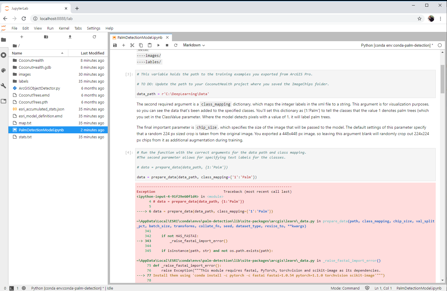

Hello,  I am working through the Deep Learning Coconut Tree tutorial and have a problem with the JupyterLab step.  I am not quite sure how to set the path in step [5] and have tried multiple variations.

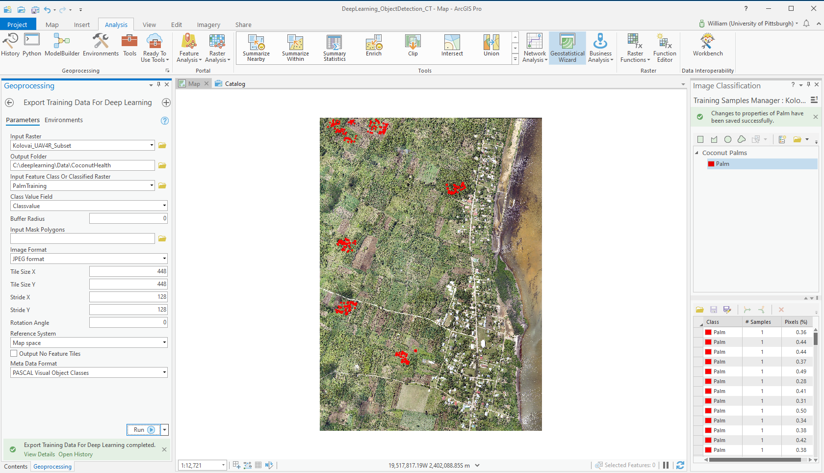

Good News:  Everything works until the Jupyter Notebook step! See below--Export Training Data was successful.

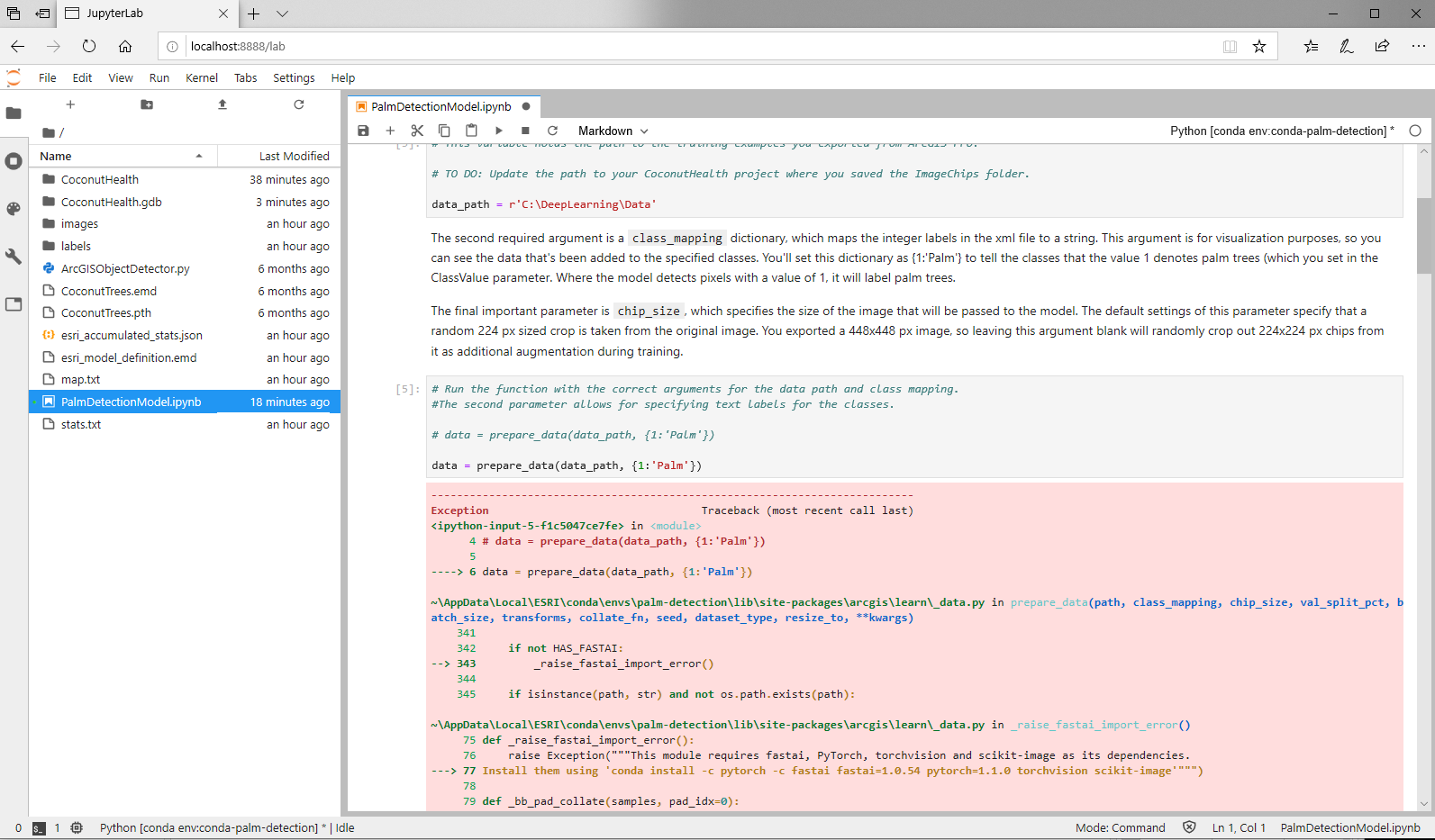

Bad News: the prepare_data steps always fails! Please note that I launched jupyter-lab from C:\DeepLearning\Data
I'm not sure what the issue is here.   I noticed an earlier thread from last year with similar questions, which was unresolved I believe.
Any help would be greatly appreciated!  Thank you.

I created a new python image following these steps:
Please note that this installation order results in downgrading of two packages: libtiff and pytorch.
I then restarted ArcPro making sure that the correct Python image was active.  I reran the Export Training Data For Deep Learning step using the above python image.  This ran well with no errors.
I then started the required cmd window using the correct python image:  Please note that this is called DL_PalmDetection in my .
Excellent!
