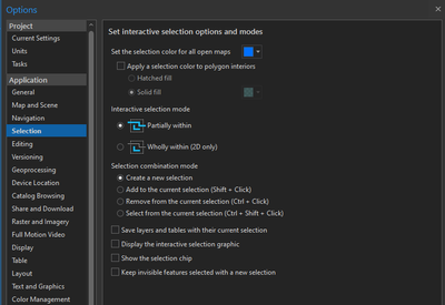

I found how to reproduce your issue.  It is in the Selection options, the one marked "Display the interactive selection graphic".
From the online documentation: https://pro.arcgis.com/en/pro-app/latest/help/mapping/navigation/selection-options.htm
  • Display the interactive selection graphic—Maintains the selection shape graphic after drawing a selection shape. This can be useful for making additional dynamic interactive selections. Click and drag the graphic to a new location and update the selection. You can also resize the graphic by clicking and dragging one of its handles.
If you uncheck that box, your select tool should go back to how you are used to.

For the Selection options:

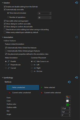

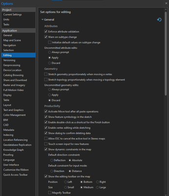

For the Editing Options:
I think the I may  have turn it off the "Enable and disable editing" from the Edit tab.
Now, I enabled it on and now i can see Edit tab show up on my Pro.
