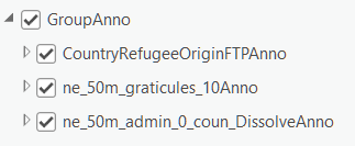

Once you have your map labels pretty much exactly as you want, then you can convert your labels to annotation. This lifts all the labels in your map frame and puts them into an annotation layer. Then you can manually move, delete, add, modify etc. This is really cool, but you can't go back, unless you want to delete the annotation and start the labeling process over again. But oh yeah!

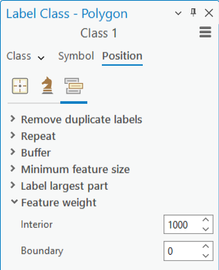

If you create polygon features covering the areas you do not want labels, assign a feature weight in the label settings for that layer to prevent labeling in that area. A feature weight of 1000 will prevent all labels from placing over the feature.

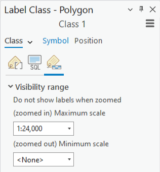

In Pro, if the same Map will be used in multiple Map frames in your layout, use the layer or label class Visibility range settings to disable the label class with the feature weight when you zoom in to make the inset maps. That will allow the labels to label in those areas when you zoom in.
