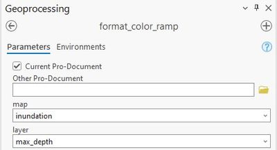

I almost tagged you on this post, as you seem to be the Resident Python Toolbox Expert on the forum.  That makes...more sense.  If you get time (no rush) perhaps you can use my below example as an example to point out anything I did wrong, inefficient, redundant, etc.  It's based off of your Python Toolbox sample code chunk on this post - arcpy-parameter-for-arcgis-pro-document .  There the guy was accessing layouts from a project via arcpy.mp.ArcGISProject(<project_name>). Mine has one extra wrinkle.  I am cascading the variable project_name to map_name to layer_name, ultimately updating the CIM of a layer in the execute method.  It works (took awhile). Note that I am truncating the execute codeblock for brevity. But first here is the toolbox look:

 As I said, it functions well but perhaps I missed or misused some conditions in my if statements.  I understand that altered property is re-assigned every time a parameter is changed and that hasBeenValidated relates to non-internal ArcGIS validation related to updateParameters method.  However I still don't understand WHEN hasBeenValidated is checked.  ex) Drop down, select parameter1, altered is assigned but nothing is validated?  So when does validation occur?
