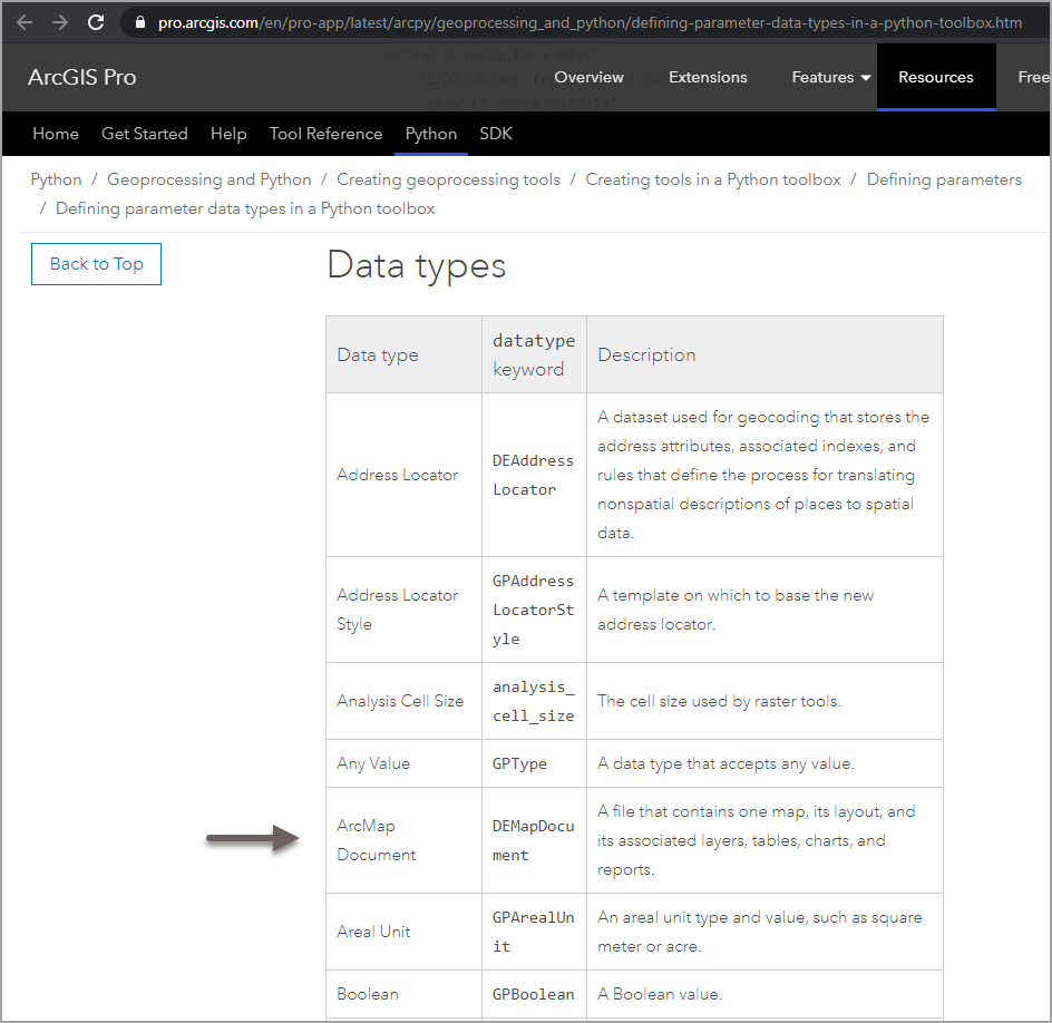

Is there a way to specify a Pro-Doc as a parameter input to a Python Toolbox? I'm writing a tool that iterates over different layouts, and exports to PDF. It would be nice to allow users of the tool the ability to specify a ProDoc (e.g. "//file/path/prodoc.aprx" or "current"). It seems that arcpy for Pro has not been updated, as it still has an ArcMap option (dataType="DEMapDocument").

The main limitation is that the "Pro-Document" input parameter does not have the nifty folder icon (see red arrow) for users to click and navigate to the document. Users have to build/write a path string if not using "current."

Why not to specify File as Data Type with .aprx extension? Does it work for you?
BR,
Adam
KennethEggering1
Datatypes of "DEFile" and "GPString" can both work with limitations. Each allow users to enter errant inputs (e.g. .txt files, or random strings), which throws an error on subsequent parameter inputs that build off it. Easily enough for users to figure out I suppose. Would still be nice if ESRI added an ArcPro datatype, allowing users to open the folder icon pre-filtered with only .aprx files.
