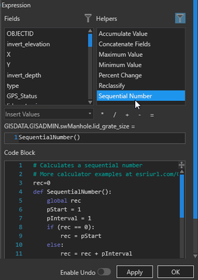

I'm using the sequential numbering script in the field calculator, and I'm trying to modify it to iterate through field values from another field so that the sequence starts over for each of the unique other values.  My table looks like this -->>  I'm trying to generate a Name with a Basin ID as the prefix.  For now, I've been just manually selecting the basins and running the script for each one, but I'd like to be able to have the script run through them all at once:
Script I'm using:
SequentialNumber()
# Calculates a sequential number
# More calculator examples at esriurl.com/CalculatorExamples
rec=0
def SequentialNumber():
global rec
pStart = 1
pInterval = 1
if (rec == 0):
rec = pStart
else:
rec = rec + pInterval
return "WA1MH"+str(rec).zfill(4)
I'm pretty rusty on python...any help would be appreciated!

DavidForbuss1
I just used the default script that populates when you click the helper...the global is built into it.
