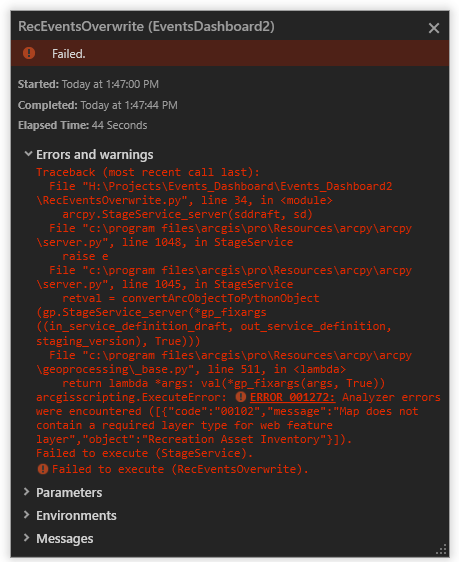

I am currently getting an error code:
"ERROR 001272: Analyzer errors were encountered ([{"code":"00102","message":"Map does not contain a required layer type for web feature layer","object":"Recreation Asset Inventory"}]).
Failed to execute (StageService)."
One strange thing about the error is that the "Recreation Asset Inventory" is not even part of the script or the project I'm working in. It's a completely different feature layer.

JoeBorgione
MVP Emeritus
Perhaps you could provide the script in its entirety.  It seems that the script is calling an aprx, and my guess is that aprx has the  "Recreation Asset Inventory" feature layer in it.

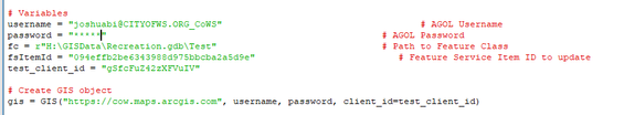

JoshBillings
Variables screenshot below:
I had to add a client_id to get around sign-in errors.
JakeSkinner
Esri Esteemed Contributor
@JoshBillingsit looks like you are trying to authenticate with an Enterprise account, which won't work for this script.  Looks like you have a client ID.  If you have a client Secret as well, you could create a token.  Ex:
