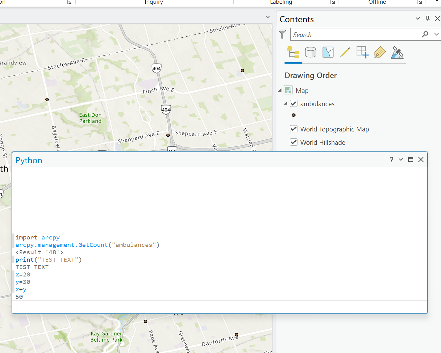

- Running PYTHON through command line through: VIEW | ANALYSIS | GEOPROCESSING | PYTHON | Python window; (see pic)
- On the tutorial file (and other projects) I can sometimes run the simple steps per the tutorial (see pic).
- However, the ArcGIS program often crashes during text entry into the command line prompt. It seems to happen every time a backspace is attempted, during attempts to paste paths, and during delays while  typing a command (e.g., searching for a file name). It sometimes happens upon any text input with or without the enter key.
- The crash starts with a 5-10 second freeze (loss of cursor control), then an immediate program shutdown with no error message. During re-start there is sometimes a notification re: back-up newer than saved file, but often the project opens fresh with no indication of the crash.
