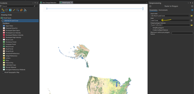

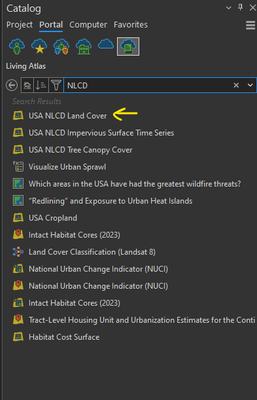

This is what you need to add in Pro
Then use the tool `Raster to Polygon` and choose Land Cover under field if you are interested in land cover types/classes

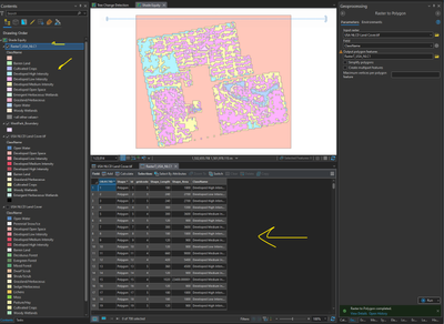

I don't know how you tried it here I have a sample converted polygon as shown below with different types of land cover types.
Here are the steps I followed to get a polygon NLCD for a specific area
1. Add the raster from the Living Atlas.
2. Right click on it and go to Data > Export Raster > under clipping geometry I selected the study area polygon.
3. Then use raster to polygon to convert the raster you get from step 2 it to a polygon feature class and select ClassName if you are interested in Land Cover Types.
You can then export it as a shapefile if need be
