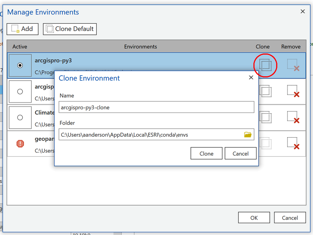

I am looking to clone my default python environment to a different folder (D drive instead of the Default C). In the online documentation, it states
"By default, the environment is created in your %LocalAppData%\Esri\conda\envs folder. To create the environment in a different folder, click the Browse button on the Clone Environment dialog box and browse to the folder." ( https://pro.arcgis.com/en/pro-app/latest/arcpy/get-started/work-with-python-environments.htm )
Where is the Browse button on the Clone Environment?
Thanks!
AndyAnderson
Go ahead and click on the Clone button, it produces a dialog that allows you to set the folder. See the attached image.
— Andy
Clone Environment dialogClone Environment dialog

AndyAnderson
— Andy
AndyAnderson
The Browse button is the folder icon at the end of the file name. You can also just type or paste in the full path to the other location.
DNVT
Ah, thank you! I was always clicking the Clone Default button at the top header which automatically creates your clone to the C drive, and not the Clone icon on the right.
AndyAnderson
Yes, I quickly moved away from using that top button primarily because I wanted different names for the new environments than “arcgispro-py3-clone”. 😀
