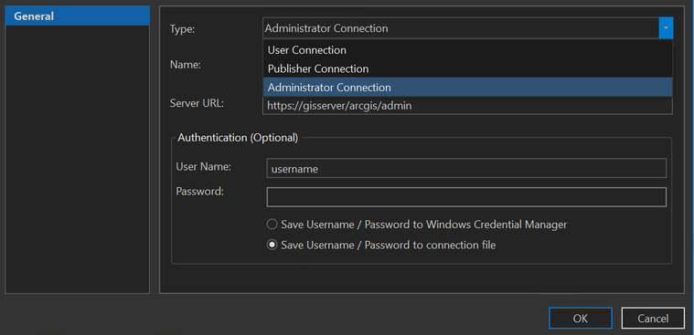

Esri Support Services for the win! Vysakh did his homework in advance and was able to walk me through the process. Turns out I did not have a Administrator Connection added. Here's why: When you add an ArcGIS Server connection in Pro, it does not give you the option to select your connection type like it does in ArcMap (use vs publish vs administer services). So, when I created my connection file, it defaulted to a Publisher connection and I never realized it.
To fix this, you have to right-click on the connection file after you have created it and open Properties. At the top of that dialogue box, there is a handy-dandy drop-down menu. Change it to Administrator Connection, and the option to publish Geoprocessing Service will magically appear in the Publish menu the next time you open it.
