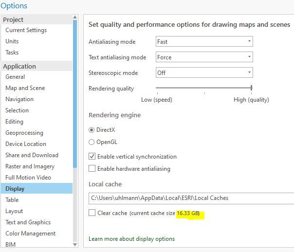

Thanks Robert.  I put in some more research this weekend before taking any drastic measures and stumbled across a LONG post here (ESRI Community forum post addressing Pro's sluggishness) where KoryKramer of ESRI pointed to this document - Troubleshooting Pro Performance Issues ESRI doc.  I'll do a little more research on differences between Performance Assessment Tool (PAT) and Diagnostic Monitor (MON) because those might be helpful.  But, I also came across a forum response of yours addressing Caching - clearing cache's specifically -clearing the cache.  I'm unsure at this point why my Pro is slow, because originally it seemed to be a network issue, but now it is hampering projects on external hard drives significantly.  I started a brand new project on my external hard drive, using only data contained in that drive.  Went to clear the cache and it's 16GB!!  Does clearing the cache inside a project ONLY affect that project?  I can't seem to find information on whether clearing cache as shown in below screenshot clears my entire cache in C:\Users\<me>\AppData\Local\ESRI\Local Caches or JUST for the project.  I did check the Local Caches folder size and it is also 16GB, so...it must clear my entire Cache, not just for one project.  Going on tangents, but hopefully some useful background info.  I really appreciate your help - Zach

Zach - that's great you found Kory Kramer's article about troubleshooting slow performance issues in ArcGIS Pro.  That certainly is a good place to start.  Another technique I've found is that renaming the ESRI folder in your C:\users\<user profile>\appdata\local and C:\users\<user profile>\appdata\roaming to ESRI_OLD helps strange issues as well.  To answer your question - when you clear the cache it's for the entire ArcGIS Pro application not necessarily individual projects.
