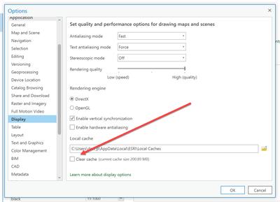

display cache can be removed here
the cache location is noted there as well
