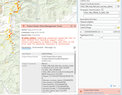

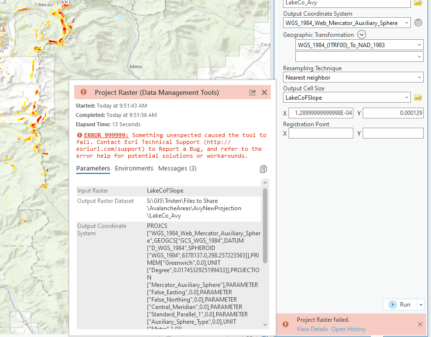

Hey Esri Community, I'm currently trying to project a raster (Using the Project Raster Tool) I have to another CS and am running into an Error and was curious if there were any workaround suggestions/fixes that you might have in mind. I have already tried to export the raster and change the projection in the options for it, but to no avail. Any suggestions on how I can export this that don't involve finding the folder in file explorer (I've already done that but want to go through Pro)?

file path is long and contains spaces and you are putting out it in esri grid format with a long filename.
send it to a shorter path with a *.tif extension, the recommended raster format by esri.
also check your cell size and see comments in the following documents
How the Cell Size Projection Method environment setting works—ArcGIS Pro | Documentation
Project Raster (Data Management)—ArcGIS Pro | Documentation
