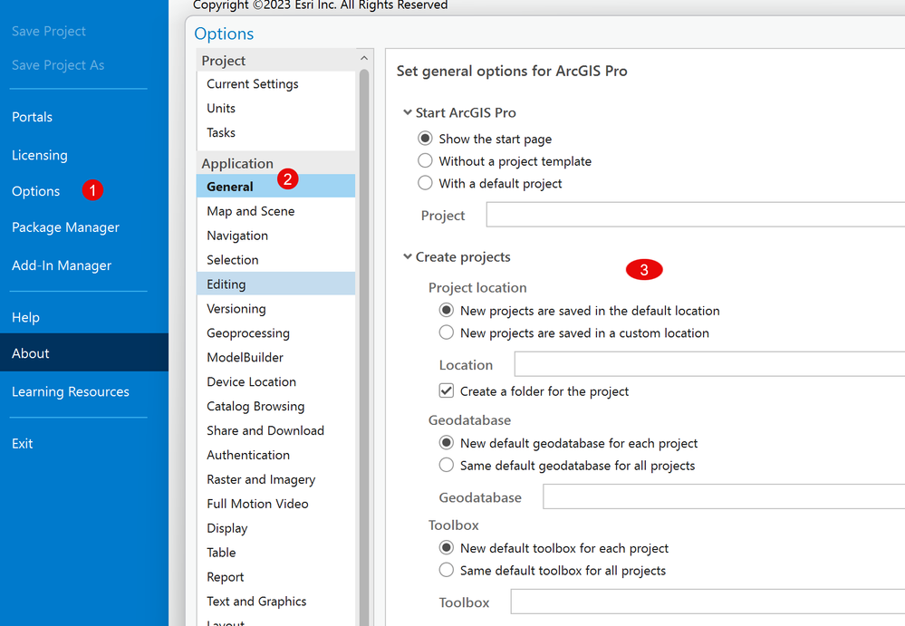

project backstage, options, general... is this what you are looking for?

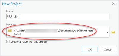

MarkGilbert
Not exactly.
What I'm really trying to do is figure out how to change, or revert back to the default, this location.
At some point I changed this to a network folder and I would like to revert back to local folder.

New projects are saved in a custom location
popping your path into there doesn't work?

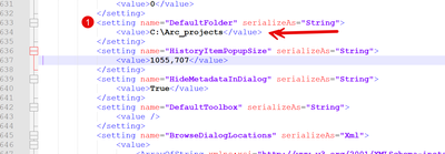

You could always have a look in your
C:\Users\... you ...\AppData\Roaming\Esri\ArcGISPro_ .... thing ... \3.2.0.0\user.config
of course the ArcGISPro_StrongName_ thing would have to be edited
Mine was found in my roaming profile, but check your local as well

MarkGilbert
Thanks for the help but I'm throwing in the towel. I'm still pretty sure there was "Project" tab in a previous version that was removed in an update and I am no longer able to change the default path which continues to be a OneDrive folder no matter what I try. I've since learned this is not a supported configuration but am unable to revert it back.
So for now, I'll just use the Custom Default Folder setting to put my projects on C:\\User\...\Documents.
