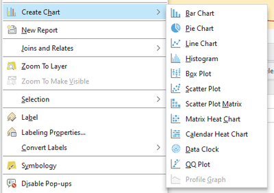

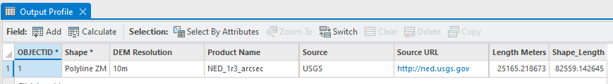

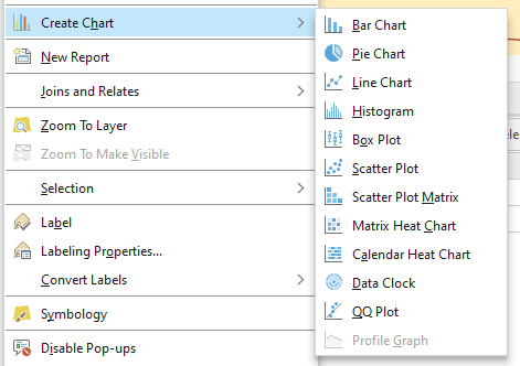

Having some difficulty with the output of the Profile tool.  Pro will not let me create a Profile Graph as the option is grayed out.  I've tried running the Profile tool via the 'Ready to User Tools' section and running it as a standalone Geoprocessing tool.  I've tried a few different input lines (eg. changing the geometry).  The tool will run just fine, and the output attribute table looks ok and the output line has z value data enabled, but the option to create a Profile Graph remains grayed out.  Any ideas of what I might be missing/doing wrong?  I'm running ArcGIS Pro 3.2.0.

just to confirm... do you have the 3D analyst extension?

That did it.  I didn't even consider the 3D Analyst extension.  Thank you.  But here's my gripe, the documentation does not state that it's a requirement:
